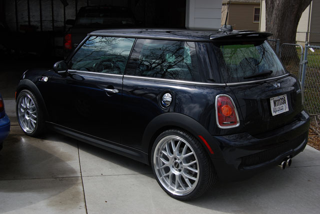

Here is my install and feedback for H&R part # 29090-1 from Germany.
I measured before and after of "overall ride height" which I measured from level ground to the bottom of the wheel arch apex. For the record, I ordered the base "standard suspension" as I had intentions to replace it all over time anyway.
Before front, 26.1" high:
After front, 24.6", a 1.5" lowering:
Before rear, 26.3" high:
After rear, 25.3", a 1.0" lowering:
The springs provided the advertised front end lowering but are a half inch shy of advertised rear lowering. Perhaps they'll "settle" over the next few days like some springs do.
The ride quality is marginally changed. Bumps and cracks in the road are only slightly more noticable; still nowhere near as abrupt and aggressive feeling as the Koni Yellows and H-Sport's I had on my R53.
I haven't had too big a chance to push the handling yet, but my initial impressions seem that there is a slight increase in understeer, which is slightly bad. What is excellent however, is the absolute elimination of all the "torque steering firmness" that stock R56's experience. This is primarily due to the lowered roll center and greater forward traction, leaving the tires with less mechanical advantage over the suspension geometry. This improved geometry makes the R56 much more "R53-like" in chassis feel and steering feel, a very good thing.
Here's a final hot pic of Astro on the dyno today, to show stance:
Overall these are recommended for the street and show enthusiast, but racers and autocrossers will want to wait for H-Sport to release their springs in hopes they're as good as theirs were for the R53.

Attached Thumbnails Lowering Springs-9_18_03_07_12_09_22.jpg   Lowering Springs-9_18_03_07_12_09_36.jpg
