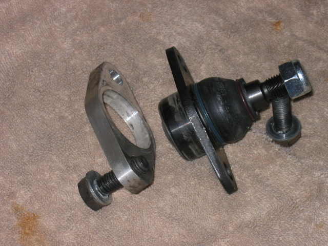

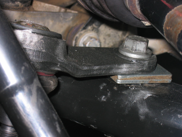

Matt and Michael,
Attached are two photos that tell the story. The "correction" is not to the control arm, per se. The "correction" is to the inboard and outboard balljoint pickup points, which in turn, restore or correct, to near stock, the control arm geometry and return the front roll center and camber compensating geometry to near stock.
The first photo depicts the outboard balljoint and the 3/8" lowering spacer that lowers the outboard balljoint. The second photo depicts the inboard balljoint and the approximately 3/8" shim stack that raises the inboard balljoint.
Of course, nothing is easy. These balljoint mounting changes cause misalignment of the steering arm and a bump steer problem. So, put together a bumpsteer "correction" from BMW Z-3 racing parts available from Bimmerworld, James Clay. Another story.
Hope this helps,
John Petrich in Seattle
Hope this helps,
