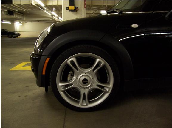

Folks,
I purchased 18" JCW Rims (Rubber: 215/40R18) and Installed them on my MC (Regular suspension), and since then I'm like !!!!!! Honostly, the car looks like a 4x4 to me, !
Therefore, I have decided to lower the SH*T out of it!!

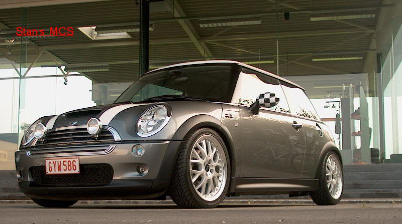

I checked number of threads with pictures of lowered MINI's, some pictures showed exactlly what I am looking for (Very Noticable Reduction In Clearence).
The confusion begins when the same type of springs on different MINI's give different Results as seen on pictures! Also, I have read that the lowering rate between the MC and MCS are not the same because MCS is lower than a MC.
Thus, my problem now is: how to pick the springs which I know will give me the final look that I want? Is it like Trial&Error Method !!
Attached is a picture of my car (Black one with JCW Rims) and the second one is Stan's MCS, I am looking to purchase springs that will give me a minimal clearance like Stan's. (He is using; KW variante 1 coilovers).
I am considering EIBACH Sportline or Pro-Kit (Sportline have a lot of negative feedback for being too low for everyday use). Eibach Pro-Kit claim's 1" drop in front and 1.2" Rear.
Another choice would be; ULTRIK which claim's also 1" drop (1/2" for sport suspension).
H&R springs are all over the place in these forums, should I consider them too?
I dont know folks, am confused here and I don't want to buy something, install it, and then regret it! You're comments are needed.
