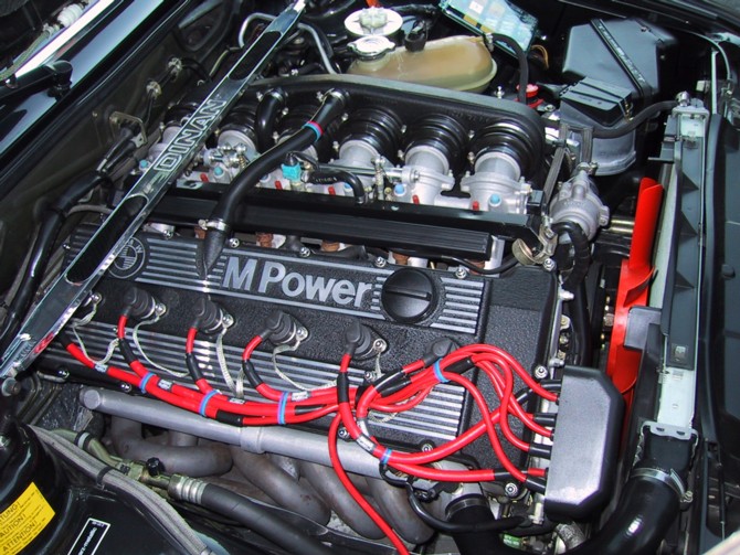

Wouldn't think twice about installing a brace. Some cars need it more than others, like my M5 (see pic). The mini is still enhaced by it, just not as much. If you track or autocross there will be a difference. It seems most of the discussion is on just how much that will be. IMHO, this isn't in the first group of enhacements I would do, but the more serious you are the higher on the list it becomes.
Attached Thumbnails Strut Brace? Necessary for rough roads?-engine-leftsmall.jpg
