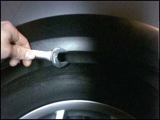

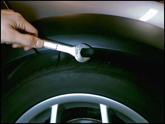

here are two pictures i took. the wrench is a 20mm. it just about equal to the space between the top of the tire and the botton of the wheel arch.
REAR:
https://www.northamericanmotoring.co...1&d=1137787962
FRONT:
i'm using 205/50/16 toyo proxes 4s FYI.
