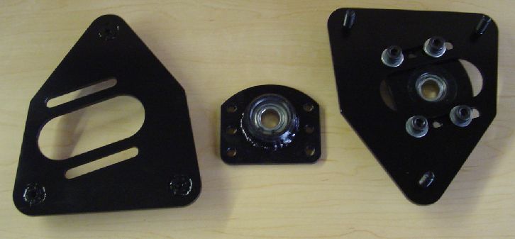

The picture they have on their website now looks different than the picture in this thread.
Attached Thumbnails Ireland Engineering Street/Race plates?-minicamberrace.jpg
The picture you posted it the race plates, not the street/race plates. The pic of the Street/race is the same as it has been for a while.
