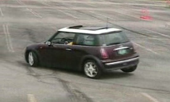

And, here's a picture of my Cooper during an autocross. My "mongrel" suspension consists of JCW springs / dampers, sports suspension front swaybar (not SS+) and RDR rear swaybar on the softest setting. Yes, this is a combination that you should not be able to get, at least not easily. Sorry for the image quality, it's a capture from a low-quality video. That is daylight between the right rear wheel and the parking lot.
