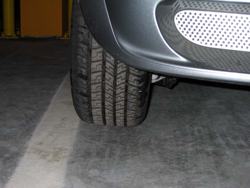

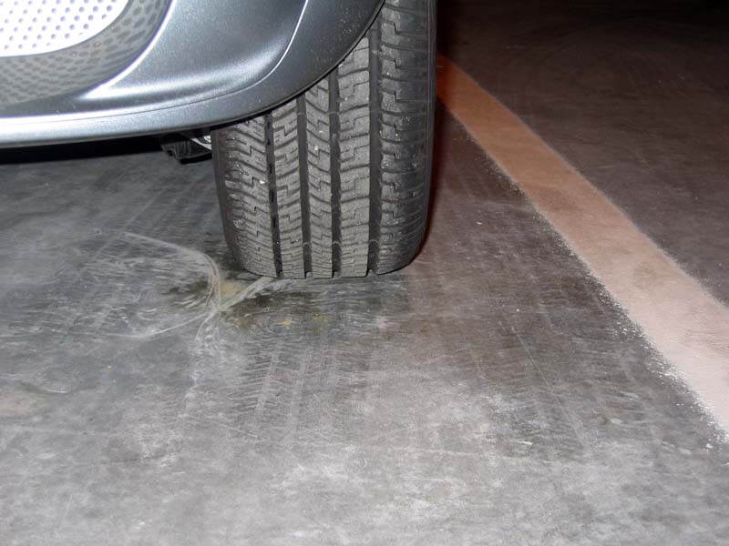

Does this look about right?
Randy installed my H-Sports a couple of weeks ago and I've asked a couple of other people on NAM and they all said that I don't need to get rear control arms to balance out the negative camber. That negative camber was actually good (especially in the twisties). I have attatched two pics of my left and right rear tires. From the dust in my parking garage you can see how the tires are going to wear. Does this look normal? I am also going to the dealership on Sat. to have them see what my rear camber is. Any suggestions on what it should be in the rear. Any help would be appreciated, thanks!
Mark

That looks normal.
You'll still get pretty good distance out of the tires though if you rotate front to back. The rears will wear on the insides and the fronts generally wear on the outsides. It all balances out in the end.

That looks about wat mine looks like too. :smile: Randy installed yours,
no need to worry.

Its pretty normal. I have the Alta springs on my car. Even though it did give it a little bit more negative camber it doesnt wear out the tires as fast as people think. My buddies are always telling me how bad the rear camber is on the car. ( I just think its funny they are always lookin at the back of the car because they cant keep up ) And u can rotate the wheels front to back like DID said. Hard cornering will even out the front .

I've just worn out the same kind of tires you have. I had just about the same camber setting as you and even more neg. camber at one time.
Your gonna find that the tires wear pretty much even all the way around, slightly more in the front based on my experience.
I have M7 springs btw.

I have M7 Springs for almost 3K and tire worn is pretty even on the rear. I rotate the tires every 1K..why? cus' that way I can escape the yard work.

I have the H sports with Bridgestone S-03's for the last 10k miles. Your rear tires will wear a little faster on the inside edge. Just make sure you rotate. I am expecting about 20k miles based on the wear that I have seen so far. The camber plates will extend your tire life somewhat, but I wouldn't spend the money unless you are looking to get a autoX or track set-up. The money spent on the camber plates goes a long ways towards new tires IMHO.

The dealership can't do anything about the camber now that it's lowered anyway. There is no adjustment without aftermarket Rear Camber Links.
Randy sells them, didn't he tell you that.
