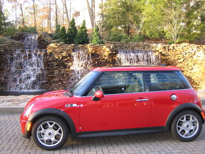

M7 Springs
I love that pic, it really shows how nice and low she is.
