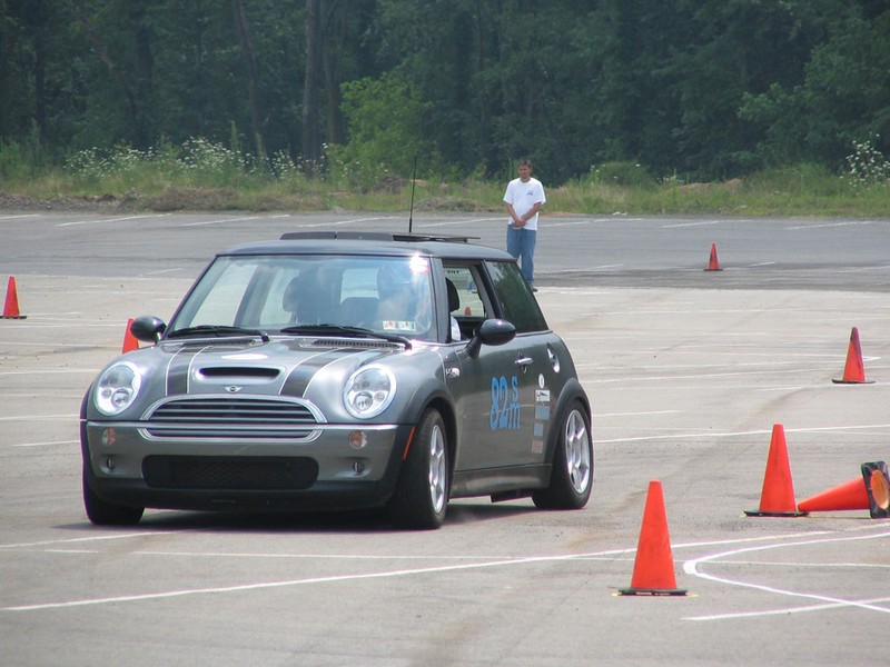

Last year I ran -2.5 front and -2.0 rear. On 15" Victoracers I had 42 psi front and 36 psi rear. This seemed to be the right amount of oversteer for me. Check out the rear camber in this pic:
