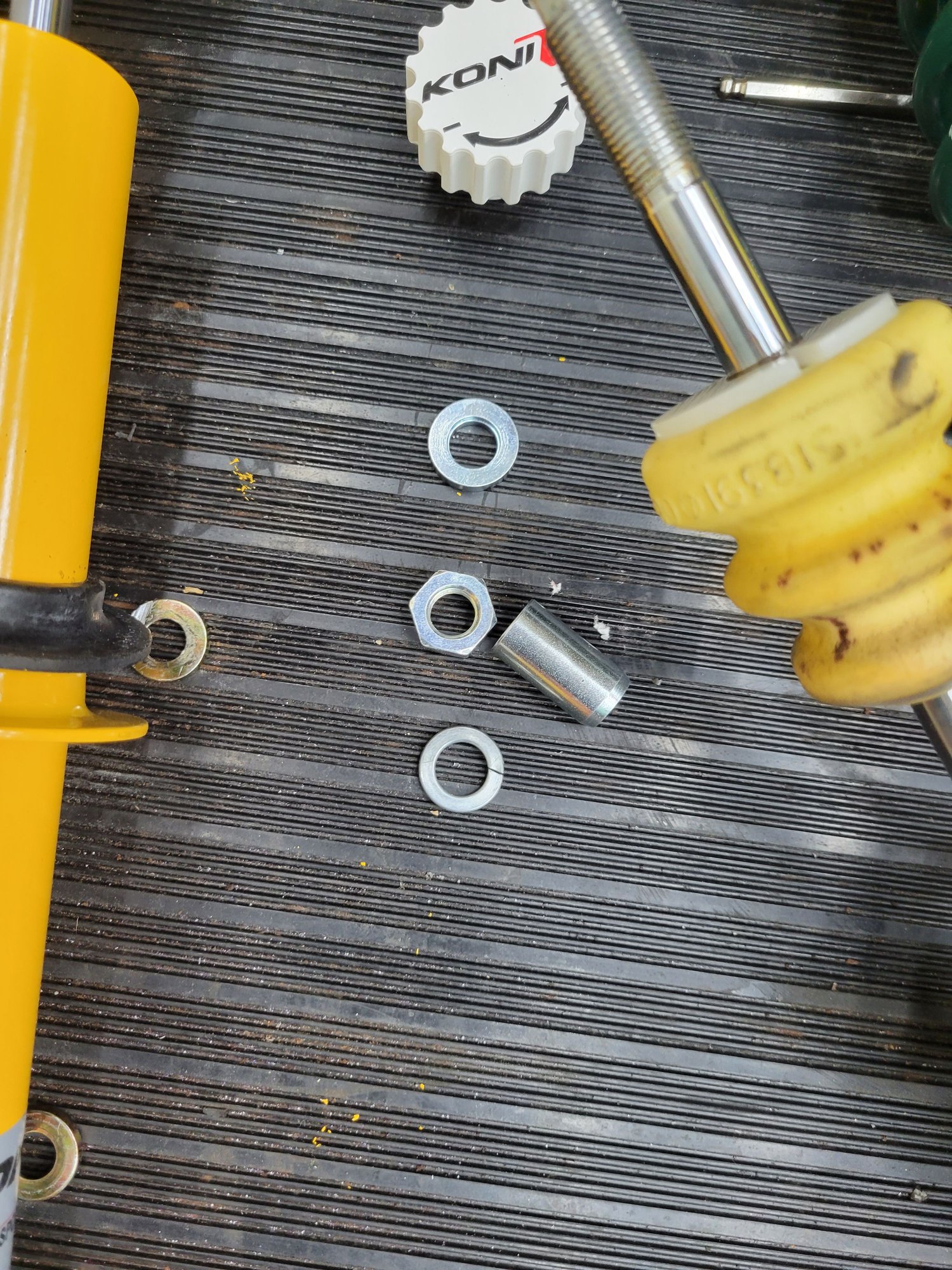

I'm trying to put together my koni yellow rears for my R53. The instructions are garbage. I have to try and figure out the proper configuration of the hardware. Anyone have some pics or better instructions???

^^ Thanks. I have the book and the general idea of the install. However, the instructions were not helpful and I am at a loss to figure out the proper sequence of what goes where. Please see the plastic spacer which we thing is correct. There there is a metal sleeve, a thick washer, a thin washer and the nut.
Side Note: I will also be using the powerflex bushings on this. I did not open them yet as I was still working on figuring this one out. Maybe they come into play here?

I run Bilstein yellows, so unfamiliar with Koni yellows, but NAM has a deep archive so did a quick search,
and found this thread which despite the title seems to quite helpful and also has great reference pics:
https://www.northamericanmotoring.co...-shocks-2.html
Made me miss seeing @pnwR53S around here though because he was such fun and always had wonderfully extensive pictures.
See also:
explanation of the plastic washer~
https://www.northamericanmotoring.co...ow-thread.html

Fantastic! Thank you so much. I search all over and had the hardest time finding anything. Super helpful!!!
