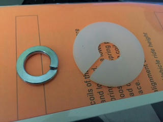

2. the rear shocks came with 3 washers(1x white plastic, 1x inside grooved metal washer, 1x open metal washer). I understand the grooved washer sits in the shaft to replace the original washer because too small, and the plastic washer is used to replace the smaller metal washer that sits on top of the upper shock bushings, which i replaced with a similar metal one I picked up from a home supply store nearby, but I'm not sure the other open washer is for. Any ideas where it goes? and Do i need to swap out the metal one i picked up from the home supply store with plastic one provided with the shock? Can anyone confirm the plastic washer sits on top of the upper shock bushings and is not the wash that goes first in the shock?

Are you talking about this plastic spacer? If so then that does not go on the top of the shock mount. This is split so you can fit it around the shock shaft and it sits all the way down below the bump stops. I keeps the bump stop from forming a seal when the shock is all the way compressed and potentially "sucking" the seal out of the shock body. It's not really an issue any more but Koni still includes them since they don't hurt anything.

there's another washer i didn't install beside the plastic spacer that came with the rear shock kit. see image
