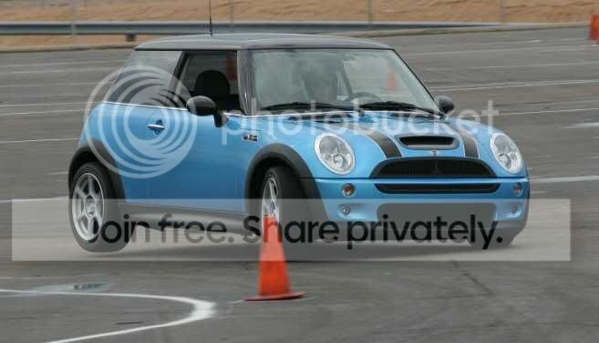

Here's a photo of my Mini doing it.
I have a Mini-Madness 22mm rear bar, Spax coil-overs, K-mac front camber plates, H-sport rear arms. I think it's just the nature of front wheel drive.
It seems to me that, while having the outside rear wheel lift isn't ideal, there's really very little difference between that and having it on the ground, spinning, but only carrying a few pounds of weight. It's just that it looks a lot more dramatic hainging in the air like that. Isn't it true that no matter what you do that wheel is going to have very little load on it and therefore won't be contributing much to handling?

I'm not a suspension expert, but in my opinion I think the rear swaybar has little to do with the rear wheel lifting. If you think about it the wheel is lifting under braking and cornering, which means the weight is being transferred to the front outside wheel. So it seems to me to solve this problem you should stiffen up the front suspension, either stiffer springs, or a bigger front swaybar depending on what handling characteristics you want the car to have. I think by stiffening up the front end of the car it will allow less weight to transfer from the rear to the front under braking and stop the rear inside wheel from lifting.
It is a little more complex than that, if you will scroll back up and look at the cool pics
you will see that the wheel is up in the opening, the stiffer rear bar is keeping the suspension from fully extending at this point because the other rear wheel is tied to it through the stiffer, read: (less flexing) sway bar and yes the weight transfer is also a factor but not really corrected by stiffining the front bar. Mabe tuning with shocks and springs but as I stated earlier I actully induce this for rotation so the rear doesnt simply follow the front
