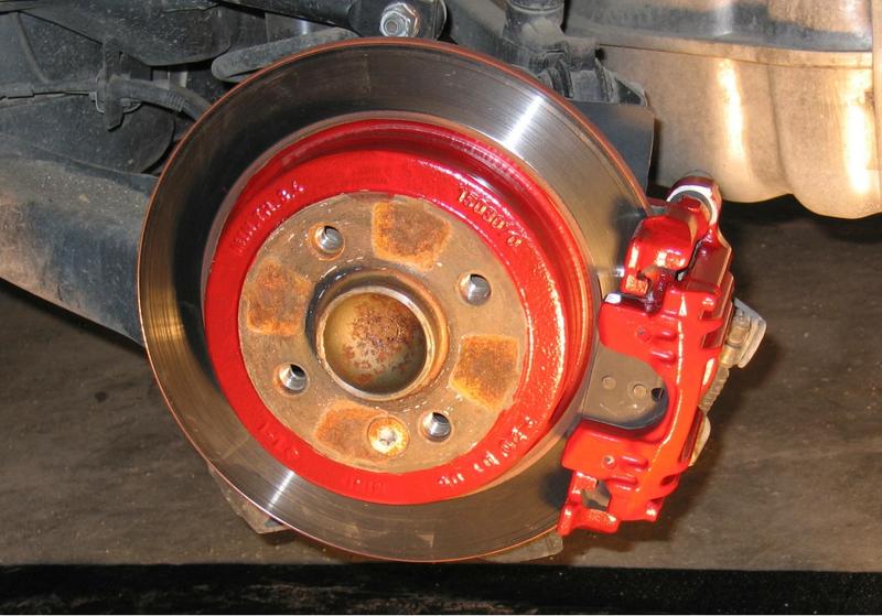

I painted my calipers too only did it while replacing pads and discs. If you want a little extra 'pop' paint the disc hats as well while you're at it. it is all in the preparation or you're wasting your time and money. Also, pictures of the finished project are mandatory. Without pictures, it didn't happen.
