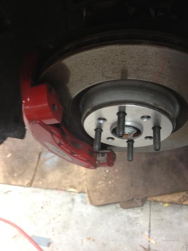

So I needed to do a stud conversion on the #0425. While I've owned very few cars (and all of them 3/4 and 1 ton trucks...well, ok, the 944 track toy, too) that had studs, I've accepted that with the GP, they're a must. Between trying to get a wheel on/off over those massive front calipers, and the mandatory requirement for shims to fit most wheels...
The other motivating factor was that the OO put 4 wheel locks on the car.... and even replacing those with stock bolts was going to be $25.... And they seriously had to go, I got tired of having to chase the one tool around. Unbolt the IA sub, remove tool, rebolt sub....unbolt sub, replace tool....
After reading a lot of threads....turns out there's not a lot of detail out there.

The first part was easy, though there's really only one option right now - Way. http://www.waymotorworks.com/m14-to-...rsion-kit.html ($97)
Turns out they meet #2, too. Couldn't tell from the pictures though!

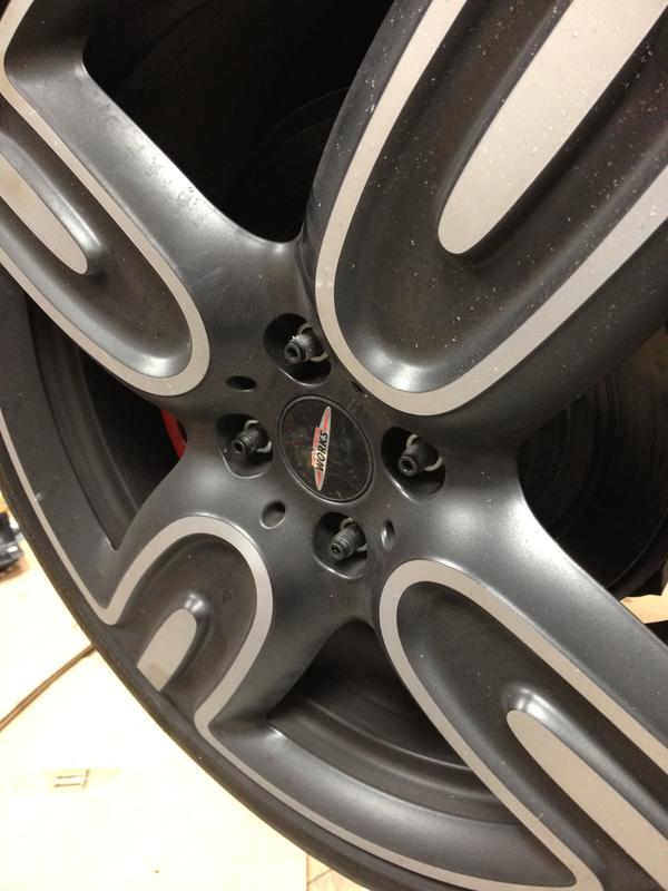

Once I installed the nuts and studs on the stock GP2 wheels, I realized there's too much stud protruding for the stock lug wrench to fit, even if they had 17mm heads.

I knew these were OK on length for my OZ Records on spacers, but from my measurements they were going to be a really close on the GP2 wheels. (either 1mm to long, or 1mm to short...) turns out they're too short. Alas, all of the 17mm head closed end lugs I could find were 34-35mm, which isn't enough. You could shave the tapered end of the studs, if you had to, I suppose...
Here's what happens if you actually try it:
