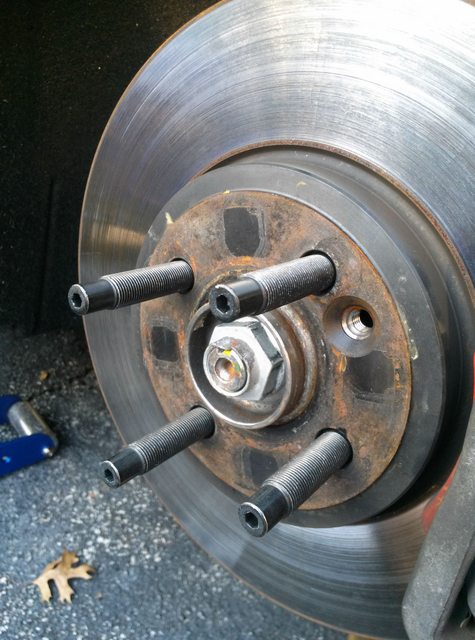

Here is a pic of the studs installed

There is a date split on the r53 because mini switched to a thicker (think 14 mm bolt) from thinner, industry standard bolt/lug ( 12mm I think)....
So the older pre2006 studs will not work...
99% of rims can be used with either hole size/bolts....there is enough wiggle room there....
