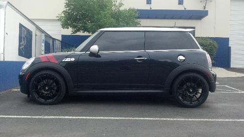

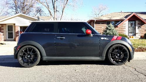

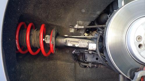

I almost forgot about pics! Is it too late? Haha.
How to: Lowering Springs-forumrunner_20140210_170108.jpg
How to: Lowering Springs-forumrunner_20140210_170127.jpg
How to: Lowering Springs-forumrunner_20140210_170200.jpg

The Mach V motorsports spring is a 1.25" drop up front and 1.0" in the rear. Easiest mod I've ever done. One hour, forty minutes.
Wouldn't mind a more aggressive drop.
