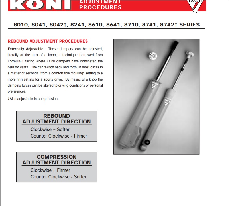

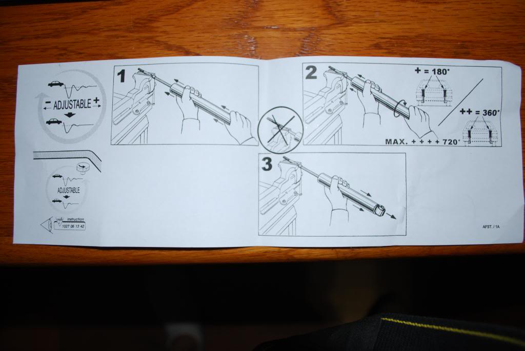

yea i want to adjust comp/rebound for my springs. i cant change valving
and from looking at this chaning compression is a major pain the the butt!

guess this pics are very old and are for a different style of shock they had back then.
and the instructions are old to i think, only rebound adjustment as far as i can tell, and read on the web.
