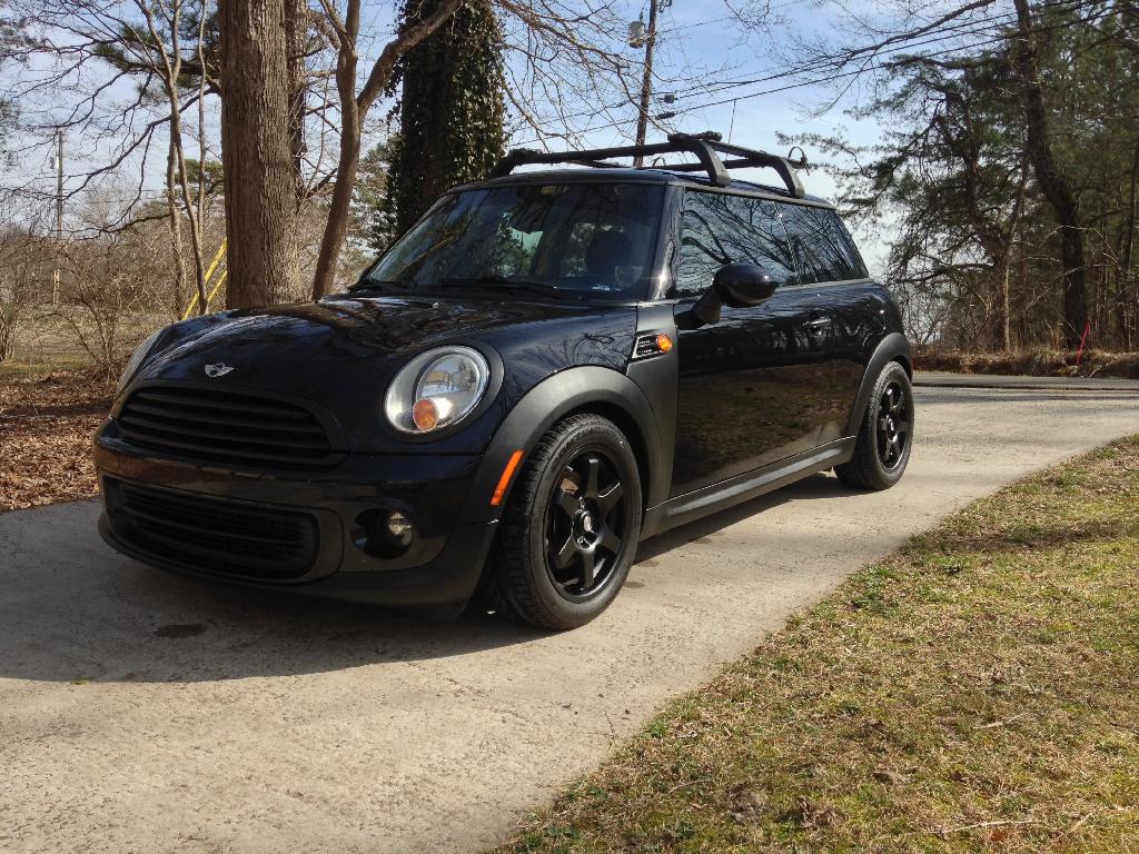

The NM springs dropped the back 1" and the front only about 3/4". I pulled the fronts back out and cut 1/4 coil off. That got me 1" total drop on the front. That is what this picture shows. I'm still not happy with the stance though. I want the front another 1/4" lower so I'm going to cut another 1/4 cool off the fronts
So cutting the nm springs didn't give you any shaky driving? Because I'm going to go with springs and if theyre not low enough I want to cut them. I'm hoping to go down about 2 inches
