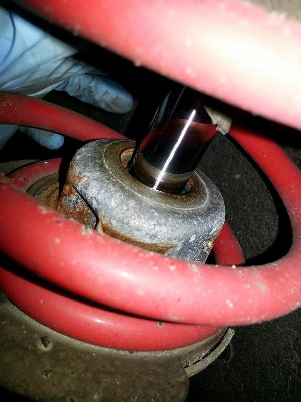

Rotated tires and inspected the shocks before the autocross last weekend. I posted one pic of the inspection - all others look basically the same. NO LEAKING whatsoever.
This is the third autocross and probably about 5-7k street miles on the FSDs and absolutely no problem.
Bob
Bob
i doubt there's going to be a problem, dampers are designed for a range of **** and it's not like there's a magic line you cross and suddenly dampers blown.
how are they performing??
If you read the first page, there is much wailing and gnashing of teeth on using the FSDs on *any* lowering springs. I really didn't expect any problems with them, but, I promised to post periodic updates on this thread.
As far as performance, they are great. For autocross purposes, they erase irregularity. One of the lots we use is pretty beaten up on the lower lot (Baysox stadium in Bowie, MD). The area where we usually put a sweeper or skidpad has multiple areas where one layer of asphalt has peeled away leaving several 1" height changes in the surface height. This cuts laterally across the sweeper and should cause the car to skitter out a bit. I had three runs down before I even remembered the surface problems - the FSDs made it so I just forgot. Then, when I was paying attention, I could feel them, but, it did not upset the car in any way.
Bob
