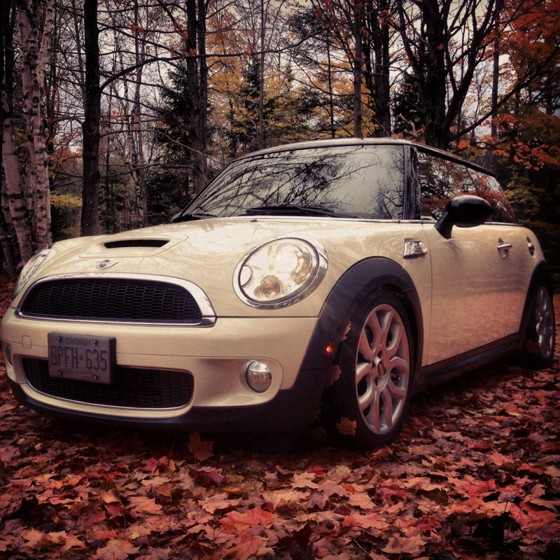

I am getting a set of BC racing coils around March time.
I was going to go the ST route but I will like the adjustable dampening and the camber adjustment.
Plus they are painted gold haha
My mini from the fall on H&R coils...
Lots of mods waiting in my basement
