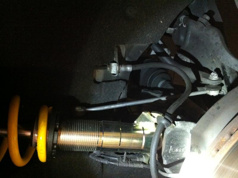

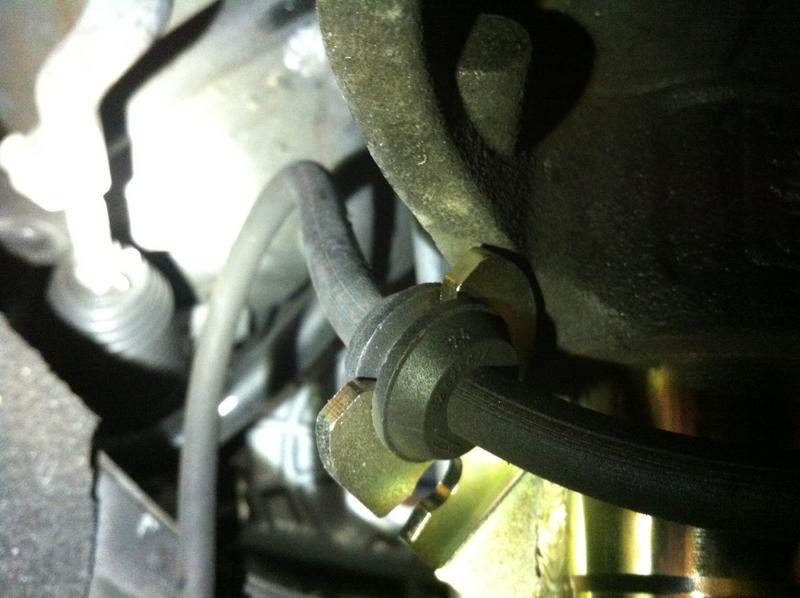

Thanks guys for being honest on not needing the rear control arms or the front end links. I will try and tighten all the nuts and bolts but in the mean time can you tell me if the install seems right? I just want to have a second opinion on this since I didn't get a chance to see how it looked before the install took place. Is the shock sitting correctly on to the mount? I noticed that one of the tabs is just sitting right on top of the metal arm. In the second picture I just want to see if the Front end links are installed in the correct position. Thanks again!

The front swaybar end link is installed in the correct place. Spring is sitting correctly on strut.
Can you see any rubbing marks on the bottom of the end link or on the front control arm indicating any interference?
In the second picture, it looks like something is positioned very close the the slot where the rubber brake line bushing is. What the heck is this? I don't have my own car up on jack stands for reference right now, but there should be nothing interfering near that location.
