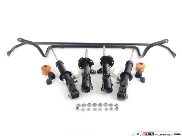

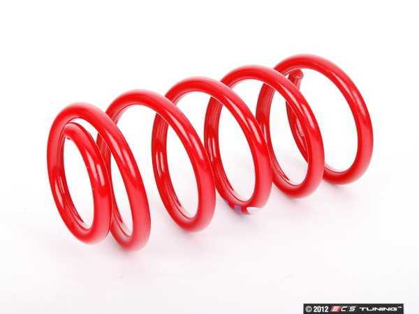

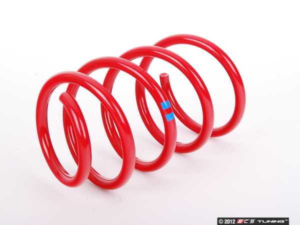

Old Oct 23, 2014 | 12:20 PM
Posts: 36,762
Likes: 2,552
Yes there is.
33500429708 JCW Sport Suspension Kit - Priced As Kit
http://www.ecstuning.com/Search/SiteSearch/33500429708/
Then You will need the corresponding Red JCW springs. They are weighted to the vehicle and options. You will need to PM you Vin and some common options, like Auto AC, Manual or Auto transmission, Xenon headlights...etc. Checks and balance. Then you get the spring part numbers 2 for the front 2 for the rear and you are good to go.
