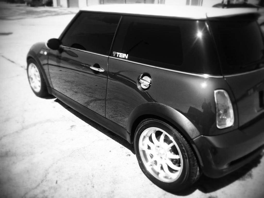

Here is my Bulldog_Blue lowered and freshwash!!!
Size:  63.0 KBName:  CAM00189_zps80e15880.jpg
