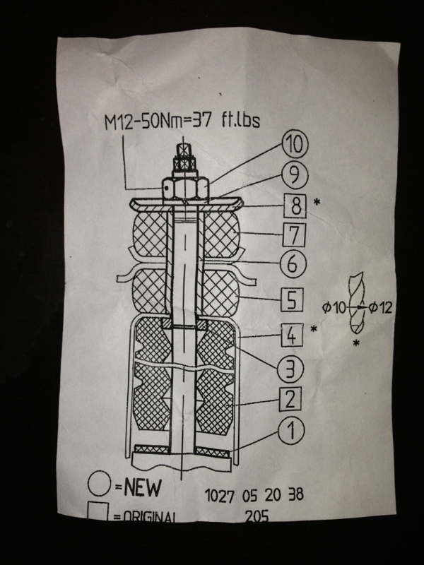

I realize this is an old thread but wanted to offer an alternative to tightening the top nut on the Konis for anyone else about to attempt this DIY project. The pics were taken after installation because I forgot to take them earlier, but it should still be helpful for anyone that needs a visual.
-I ground flats on a 19 mm 1/2" drive deep socket using a bench grinder to fit a 22mm crows foot socket for my torque wrench
-Place and 11mm 1/4" drive socket on strut shaft for the front (9mm for the rears).
-Place modified 19mm deep socket over the 11mm socket for the strut shaft nut.
-Place 1/4" drive extension through the 19mm socket to connect to 11mm socket
-Used a 1/4" to 3/8" adapter to connect extension to a breaker bar to hold down strut shaft.
-Torqued down to 37 FT-lb per Koni assembly instructions
Hope someone finds this handy in the future.
