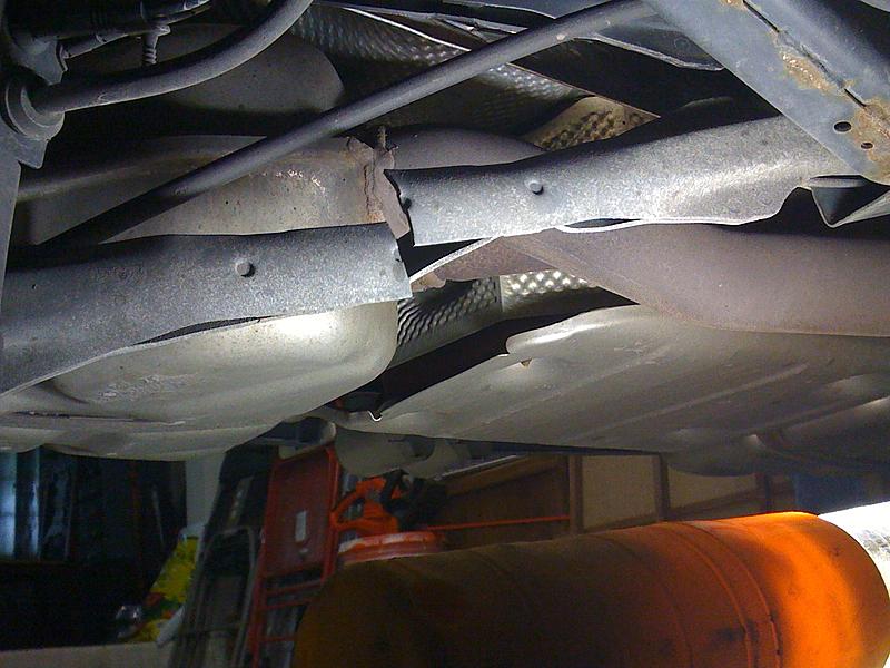

Hello Everyone,
First time contributor long time reader. Last year I purchased a 2004 MCS and have loved driving it each day. Today, marks my first major repair and would love to read your advice. A picture of the damage is attached and here are my questions:
1) Is it OK to drive on the highway with this kind of damage?
2) How difficult are these to repair?
3) How many hours should and amateur expect on this type of repair?
I'm extremely bummed about this and hope its an unusual type of occurrence. All your responses are appreciated in advance

I wouldn't drive with it like that. Should take an amateur an hour to replace.

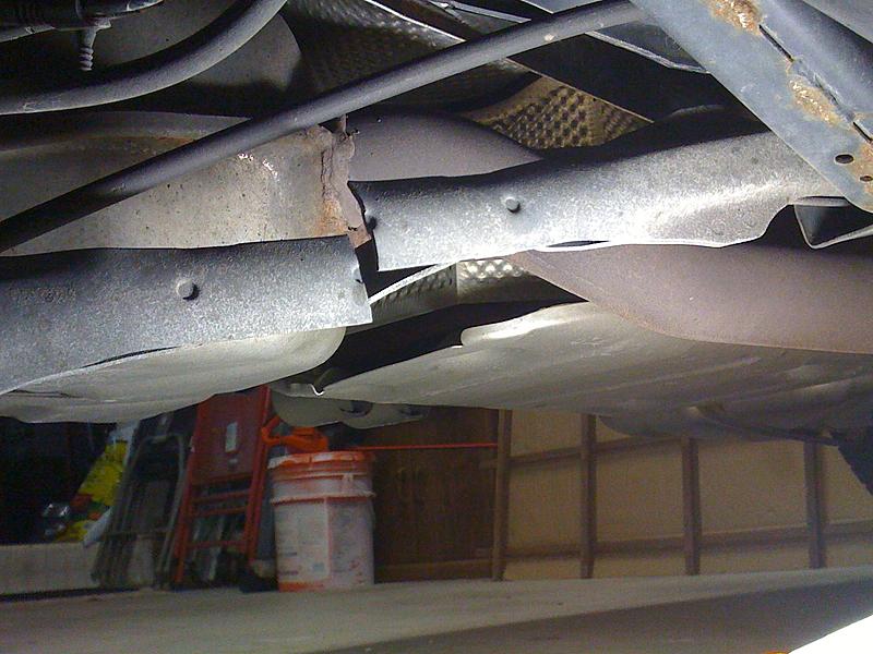

The two bolts on both upper and lower wishbone arms have a strange head size which appears to be between 17 - 18mm size. Does anyone have any experience removing these bolts? Can you offer a tip for removal and installation? See pictures attached.

Here are a few pics of the bolts and their orientation on the car. Their accessibility makes them difficult to manipulate.
Anyone have some tips?

I just replaced both lower arms myself. WMW is right. Not a big deal. I used a breaker bar with a socket on the bolt head to hold it still and a box end wrench on the nut for the center mount. The bolt that mounts the arm to the wheel hub assembly is just a bolt. Remove damaged arm and replace with new. Assembly in reverse order. I believe that I used an 18mm six point socket and 18mm six point boxed end wrench. One hour tops for repair.

Thanks for your input. What type of socket did you use ...metric or standard? These nuts and bolts appear to be an inbetween of both standard and metric. My local dealership advised me to change both upper and lower arms because of a change in arm design. Apparently if I only change a single arm the wheel will never be 100% balanced. Has anyone else heard of this?

They are metric.
It stands to reason.
There can be mods between model years and production runs.
If it happened to one it could happen to the other one.
I am more concerned by how it broke.
Almost a perfect shear.
Would advise looking at the entire rear section for any loose hardware.

Upon close inspection it is a clean break in the steel ...I suspect this was part of a bad batch of steel and there are probably other Mini's out there with the same problem. I realized there was a problem while turning left, onto my street, accelerating in mid turn the car had a noticeble slide to the right. I pulled into my drive way and within 3 minutes was staring at the first picture I posted.
Having never felt or heard a snap or ran over anything large enought to cause this kind of damage, I was totally shocked.
I'll be going to my closest sears and picking up a gator-grip socket to finish the job, asap.

Hello everyone! I finished installing my lower wishbone and also removed the top for a close inspection. the upper is made of thick gauge steel versus the original lower arm was made of aluminum! No wonder it broke! After assembly I was eager to get "Cali" out on the road again. Withdrawl was making me itch!
Thank you all for your help your advice was right on and of great benefit.

A fellow SSM member just had a lower control arm break just like yours.
Same shearing break.
This is not a normal break by any means.
The stress load runs along the axis from the mounting bolts.
Would expect to see rip break running diagonal.
Shearing 2 pieces of metal at the same point?
Would show this to Mini engineering reps ASAP.

Upon further inspection of the damaged wishbone, i realized it was not an OEM part. I purchased my MCS used and while, the carfax report was clean I suspect the previous owner ran into a curb or gaurdrail or something to cause the replacement of this particular wishbone arm.
OEM parts should carry an import stamp with the country of origin this faulty aluminum part did not have any markings at all. Plus it was aluminum! I suspect the SSM Driver you chatted with was also using an aluminum part.
