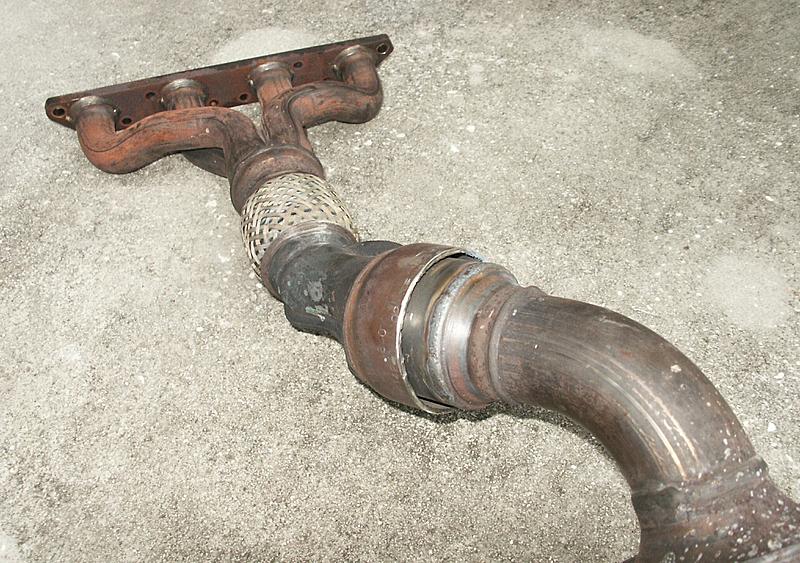

I experienced a slightly louder engine noise on my 2002 MCS. I continued driving for a few weeks until my shifter cable broke. During the repair we found the cat was cracked at one of the weld seams. Took the Cat to a weld/fabrication shop and they did a great job repairing it. They had to cut the heat shield back an inch or two to get to the cracked weld seam.
Attached Thumbnails Engine sound louder after lower control arm bushings and new tires are put on?-cat-weld.jpg
