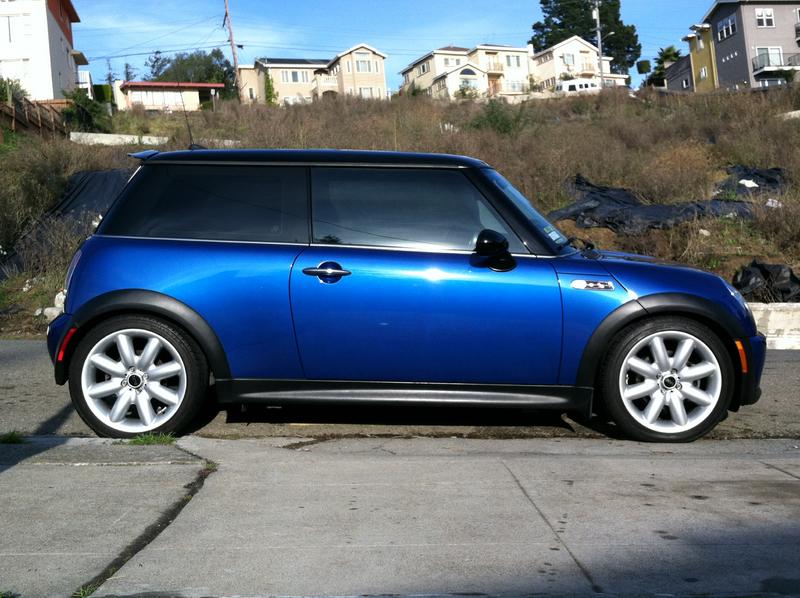

here's mine on swifts with ie fixed camber plates.
Attached Thumbnails Swift Springs finally coming out with lowering springs-img_0489.jpg

From: Austin, TX
what tire size are you running?

From: Bay Area, CA
How's the ride?

the tire size is 2054517. i have these springs on the stock struts. the ride is very nice. they do get harsh on big dips on the highway but i think a good set of shocks will fix that
