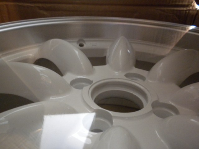

From: abbottstown, pa
UPS man came today....yeah!!! But just a sneak peek My wheels that I have been waiting for about 5 months are finally here. Along with my H&R rear swaybar and my alta endlinks were delivered yesterday. (Yeah, yeah I know, not everyones favorite)
But here is my thought: everyone (mostly)complains about the heim joint designs, how they tend to become noise. How hard would it be to change the joints to a diffent style?? like the ball-stud joints like powergrid, tsw and wmw. Yes they might have better "ends" but I think the middle section just looks like a medal rod.05-08-2010 08:41 PM
