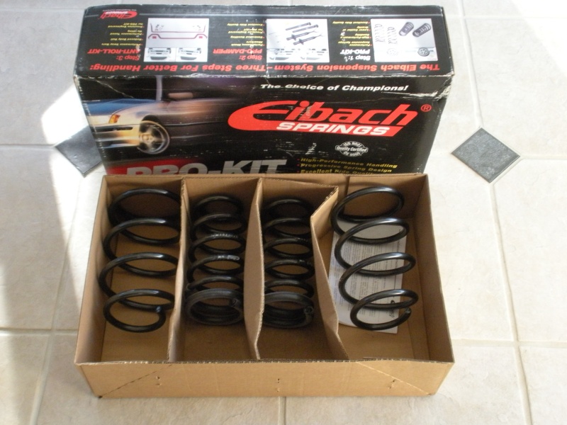

Eibach pro-kit arrived for my R55. I'll be busy this weekend.
I'll take some before and after pictures with measurements.

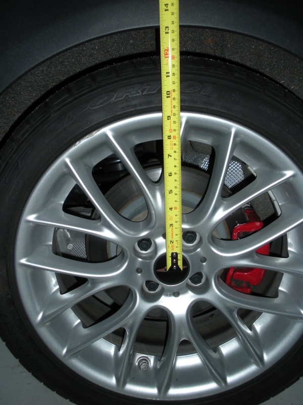

Measured from the center of the wheel it looks like it is about 14 1/4" for the front and 14" for the rear
Attached Thumbnails Eibach pro-kit arrived-front-before-drop-800x600.jpg   Eibach pro-kit arrived-rear-before-drop-800x600.jpg

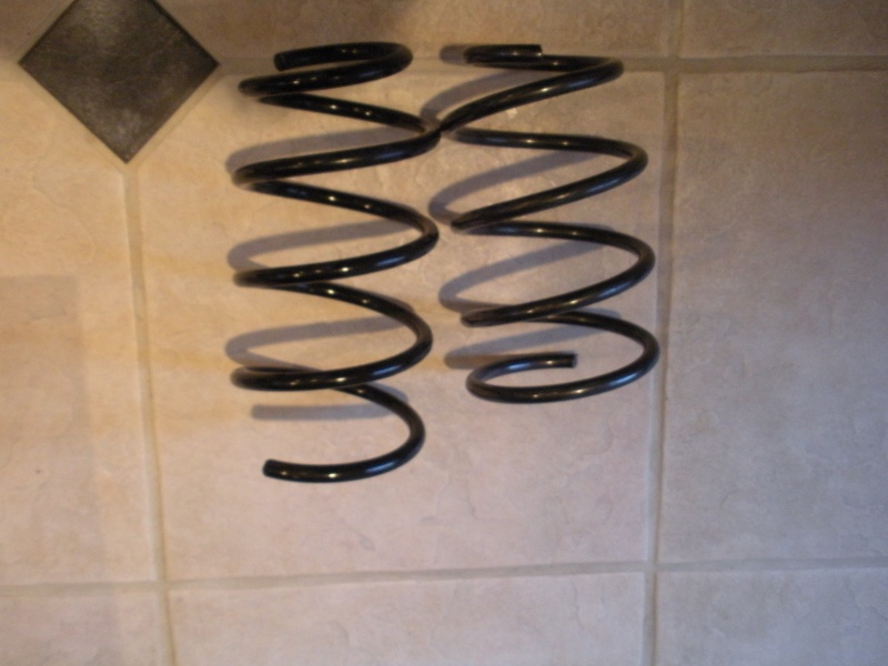

I took some measurements and pictures. It looks like the front dropped about 1.2" (just as advertised) and the rear about .5"-.6". I believe Eibach stated it would be a 1.2" drop in the rear as well. Granted the springs still might have to settle a bit, I only took it out for a spin around the block. The kit I bought was the 5706.140, the one for the Clubman.
The ride doesn't seem to be any harsher than before, but it definitely is more flat around the curves. We'll see how it handles after an alignment.
Pictures of measurements to come later...
Attached Thumbnails Eibach pro-kit arrived-dscn0831-800x600.jpg   Eibach pro-kit arrived-dscn0832-800x600.jpg

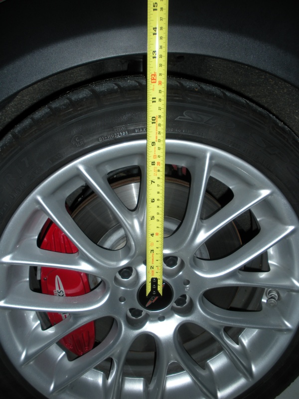

Front and rear after the lowering kit. I wish it would've been another inch, but I guess you can only get that with a coilover.
Attached Thumbnails Eibach pro-kit arrived-front-after-drop-800x600.jpg   Eibach pro-kit arrived-rear-after-drop-800x600.jpg
