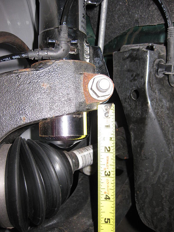

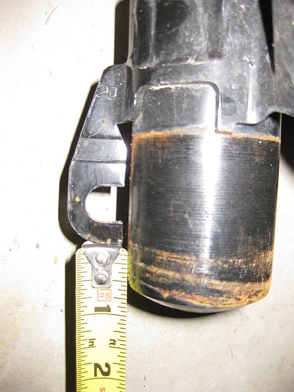

I installed the KW V1 on my 09 factory JCW this AM. I'm having space issues on the front near the bottom of the spring as it is rubbing against the tire. I have the stock 17 in Challenge Wheels on the car. I know Minitauro is running similar setup with no spacers and same wheels. Wondering if anyone can look at these pics and tell me if this looks right or if the bottom of the strut is sticking out too much at the bottom near the pinch bolt. You can see a huge difference in the measurements between stock and the KW's. Any help would be greatly appreciated before I go any further. It's already undriveable unless I buy spacers or go back to the stock setup. Either way it's a lot of work and more down time.

It's all right.... here in Germany many people have problems with OEM rims and coilovers. It is because most OEM rims have ET 48 or 52, so there is not really much space.
Get some spacers and everything will be fine !

or raise the car?
