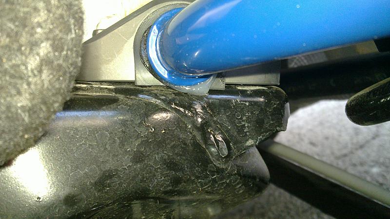

Hey Calvin,
I would suggest you revisit the bolts and brackets and try to complete the attachment properly. I don't know how much of the engineering and physics you want to know but surfice it to say, its not good to leave it as is.
For more and possibly unnecessary information:
You see, the function of the bolts is to attach the bracket to the frame so that the forces from the bar transfer through the brackets into the frame. In this capacity, the bolts will be subject to the forces in Tension which is what they're good at.
Problem is that right now with the brackets separated from the frame by a gap, all the forces from the bar are being transfered into the brackets, then into the bolts, and then into the frame.
I know it may sound weird but you don't want the bolts to become a separate load carrying link. In that capacity, the bolts will be subject to several forces like torsion, and sheer that they are not really good at handling. The bolts are probably not strong enough to perform in that function and its likely that they will eventually fail. If they fail, that could cause other damage.
I don't know where you are located but if you feel unsure of yourself with this you could post for someone nearby to help you out and take a look. It's better to be safe than sorry.
Good Luck

thanks for the suggestion,
and i took your words to revisit the bolts, and i have tightened them to sit as close to the subframe as possible.
i took a picture, and please help to check if that's OK.
-calvin

Hey Calvin,
From what I can see in your picture, it looks pretty good. Important thing is that the bracket is firmly in contact with the frame.

djd,
i think that's the best i can do at the moment, because i was afraid to stripe out the threads as i tighten it any further.

The bolts holding the brackets should be torqued to 25 ft. lbs. but it's mighty hard getting the wrench in there. Just make sure they're good and snug. You're picture looks good, absolutely you should have, no gap, none, between the frame and brackets. Good luck.
