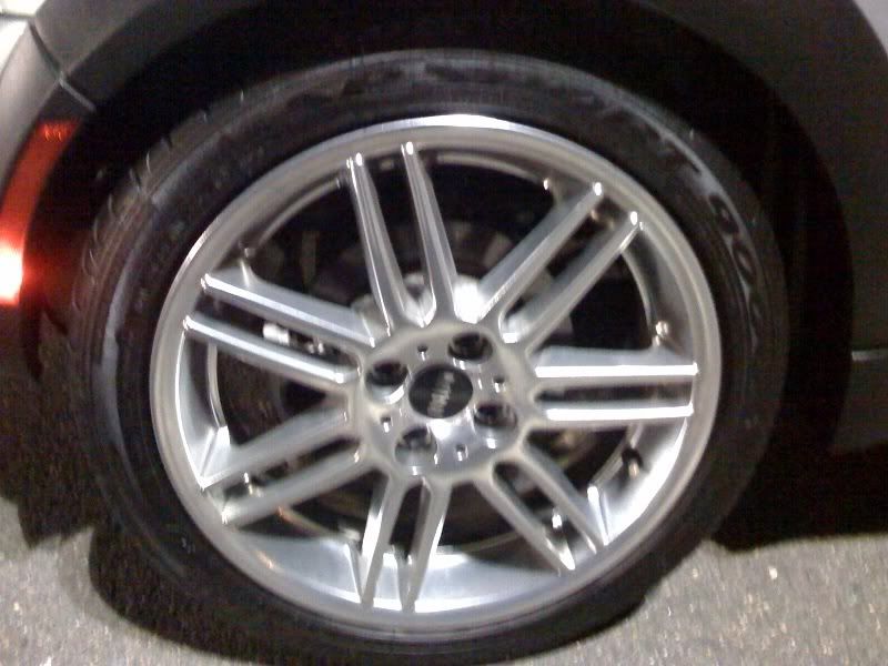

Will my wheels fit with BBK from Wilwood
Was told my MINI wheels won't work with the wilwood 12.19 4 piston setup I just ordered today. Not sure of the model wheel since I am new to MINIs and only had my for 6 days so far. Pics included of wheels, any help would be great. Can afford new wheels, but really love the look of these on my car 17x7.

LV2CNR,
I have the Wilwood 12.19 kit on my 03's with 17x7 R90's (Mini stock wheels) and fit fine,i pretty sure you'll be ok.In the instructions it says the kit will fit 17'' wheels.Don't know the et of those wheels but the R90 is 48.I believe worst case you'll need 3-5mm spacers if at all.If you ordered your kit from Todd at TCE he can help,very knowledgable guy.

thanks for the info, got them through my old gto shop. Mach V motorsports is right around the corner and they have spacers in stock.
