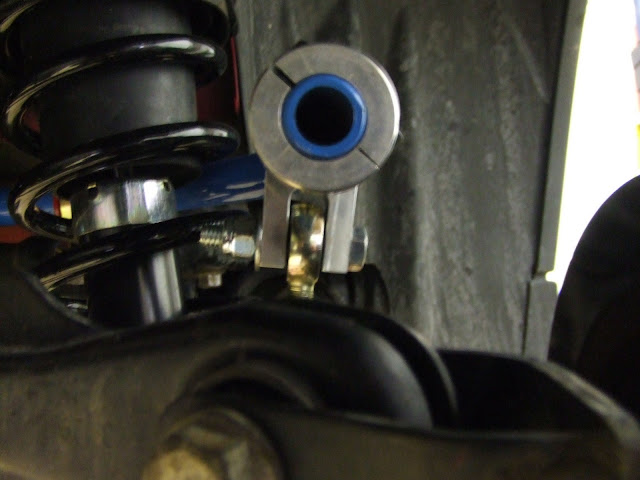

OK after more research and customer feedback and testing we have things to share and confirm. If the unit is install as designed it will make little to no noise.
1st issue, don't push the C-clamp adjuster too far back. If it's too far back, within 3/4 of the end, it will hit and rub on the control/trailing arm under movement.
This pic is a good place to start with the adjuster. The black marks are inch from the end of bar towards the bend. The C-clamp is centered on the 2 inch mark.
Also note that the disk on the end is not designed to be there, but since it's a PIA to fit next to the body mount we just use them as a safety if the C-clamp, which never has, does get loose.
Note in the below pic that you want the C-clamp in such a way that it doesn't bind on the joint as in pic.
I hope this helps you adjust and install the bar with less noise. It's a great value and works really well if installed with a little extra TLC.
Thanks Dustin
Thanks Dustin
