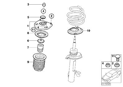

one thing I would love to see is a photo of the top of the strut (or whatever sits under and against the bottom side of the strut tower. I am trying to visualize the stresses there and see if I can envision the plates doing the job they are intended for. I did buy the cravens today so I must believe something.
cheers. Peter
Old Apr 28, 2008 | 01:58 PM
  #43
glnr13's Avatar
glnr13
Joined: Mar 2006
Posts: 1,737
From: Los Angeles
cheers. Peter
h-sport (hotchkis) camber plate:
the aluminum parts are what sit directly under the strut top mount area on the MINI.
the adjustable areas show thru the strut top mount area. the camber plates basically sit flush against the bottom surface of the sheet metal.
the blue parts are the spring hats
this is the OEM piece:
the center section is made of rubber. many people on these boards have cracked the rubber part and in extreme cases the sheet metal has cracked as well. it's thin metal in comparison to the aluminum camber plates available on the market

THat ain't aluminum...
it's steel.

Yep... I have a set of those in the garage right now waiting to be installed in a friend's MCS. Nicely made, I must say... although the bearing mount between the plate and the strut does not look good for ride quality...
I'll try to explain the functional difference between the M7 and Craven plates... Simply put, The strut mount is the part that is failing. The mushrooming of the tower is secondary damage. This is why everyone says to really fix the problem, install camber plates.
The M7 plates reinforce the assembly by adding thickness to the tower, but does little to keep the mounting studs aligned due to required manufacturing tolerances of the mounting holes and the limited size of the studs. The Craven plate reinforces the strut mount by increasing the effective size of the mounting studs and then tieing all three together.
Because the M7 plate is designed to make use of the OE strut mount studs, the actual mounting surface and contact between the parts is only marginally increased and because the actual mounting thickness of the plate at the stud is relatively thin, the studs can still splay out, although to a lesser extent than if bare. I know this for fact from when I removed M7 plates that I had previously installed. They went on easily as the strut mounts were brand new. I almost needed a pry-bar to get the damn thing past the splayed studs after a coupple of years of daily driving..
Bashing M7 is not my intention. I'm just telling my experience. When the whole mushrooming issue came to light a couple of years ago, we purchased the M7 plates in an effort to prevent it. However, I was never very happy with how they fit, so we continued to look for new options. After installing both on a number of cars, I like the design of the Craven plates better and I hope I've adequately explained why. If another company comes along and offers a new design and it turns out the Craven plates aren't doing the job, I'll give thsoe a try. If you have M7 plates and they're working for you, there's no reason to change.
