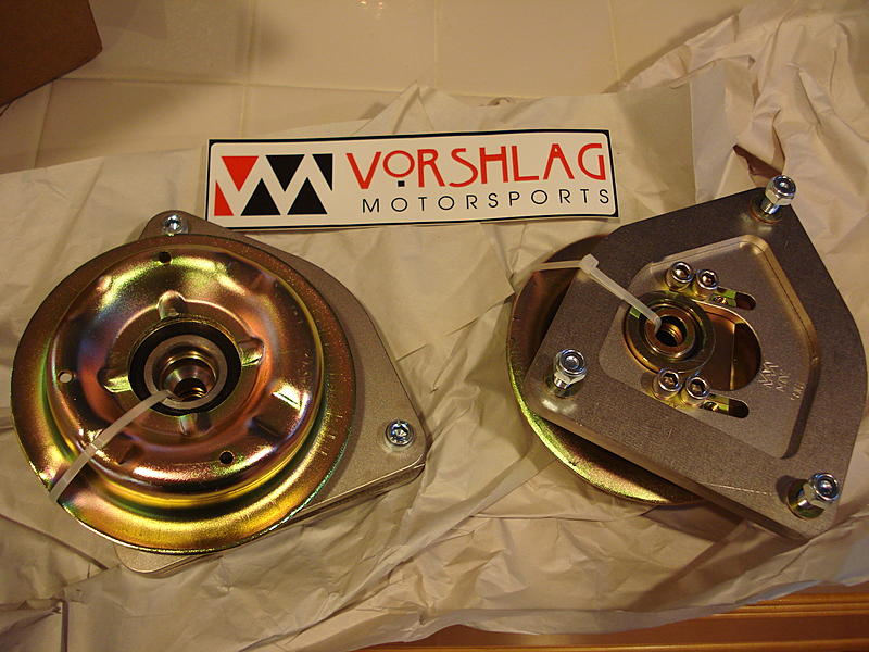

Another thing we noticed on the Vorshlags was that inner shoulder, were the strut seats up inside the plate, was cone shaped and the OEM strut shoulder is flat. Making it not the optimum seating surface. Remember I said OEM strut, not sure about other coilovers and struts.

From: SoCal
pictures
here are mine...
Attached Thumbnails TSW's New Camber Plates... get ready!-dsc03444.jpg   TSW's New Camber Plates... get ready!-dsc03453.jpg   TSW's New Camber Plates... get ready!-dsc03470.jpg

Originally Posted by O.C.abrio
here are mine...
Yep those are the ones. If you look closely at your first picture, the one showing both plates, the plate on the left, the upside down one. The seat up inside is conical shaped, you can see it on the pic. The OEM strut has a flat surface that mates with that surface, not optimum. Now most people that use camber plates are not useing OEM struts so there is no problem then, as long has whatever you are using seats up good.

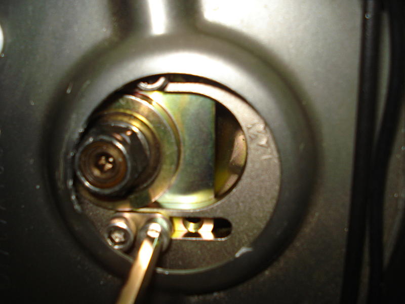

here are mine...
Are those installed correctly? How the heck do you make adjustments when half the adjustment bolts are covered by the sheet metal????
Old Sep 25, 2009 | 11:01 AM
  #89
O.C.abrio's Avatar
O.C.abrio
Joined: Aug 2008
Posts: 68
From: SoCal
these are oriented correctly. there are markings which tell you which side faces "out" during installation.
No alignment has been done yet, but these seem set for max negative camber. I agree...the adjustment bolts are not assessible with a standard allen wrench at the current setting. One of my pictures shows an allen wrench in one adjustment bolt...and how I can't currently reach the other bolts. I'm no expert, but it looks like there is an alternative hole to move one adjustment bolt over for easier access. We'll see after the alignment next week.
I have seen this same adjustment issue with similar camber plates (Cross, Megan, etc.).
The people I know that use them end up cutting the hole bigger. That is one reason I really like my hotchkis plates. But the hotchkis plates will not work with struts that go all the way thru the camber plate.
