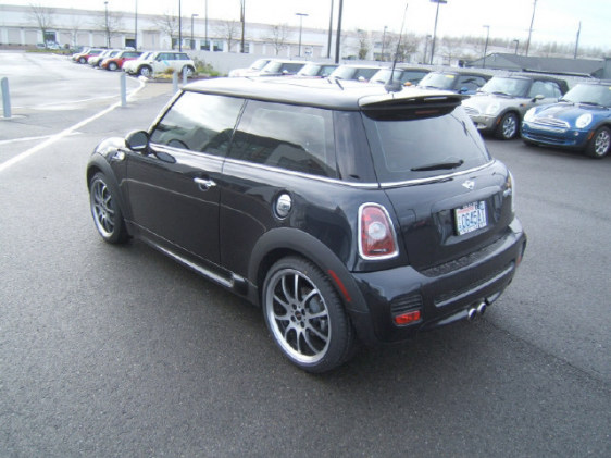

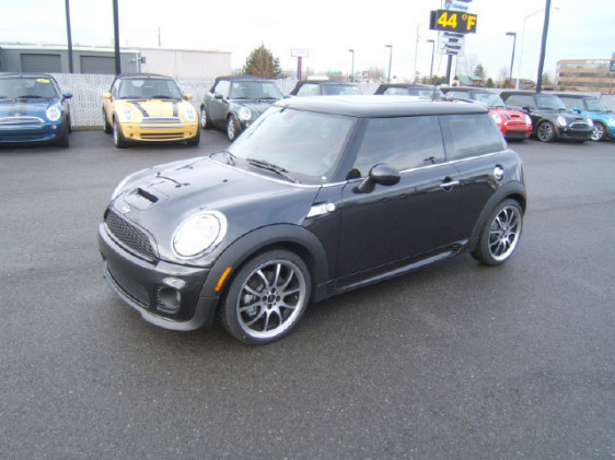

I just purchased my '08 MCS with sport pack last Saturday and was thinking of getting some Eibachs; primarily for cosmetic reasons. Reading the various posts here has since made me reconsider getting lowering springs. Plan B is purchase some 18" black Ultraleggeras (sp?) and mount up Toyo Proxes 4, 205/40/18 tires; which should fill in the wheel gap about an inch or so over stock. At the Mini Dealer there is new '07 with JCW Aero Kit and factory JCW 18's, which from the front/side looks ok. I'm figuring the Ultra's should be lighter than either my stock 17's or the JCW 18's, plus the Toyo's should be lighter than the 18" Dunlop runflats, so my ride quality and handling should stay pretty close to the way it is now...Excellent. Comments?
I will post some pic's of the '07 MCS with JCW kit and wheels.

I was thinking the one inch greater diameter of the 205/40/18 compared to the stock 205/45/17 might decrease the wheel gap a smidge? Pic's attached of the '07 MCS with Aero and 18's.
Attached Thumbnails Illusion-2007-mcs-jcw-18-s.jpg   Illusion-2007-mcs-jcw-18-s-2.jpg   Illusion-2007-mcs-jcw-18-s-3.jpg

Here's what happened when I put 17's on my Merc before lower springs. Original Wheels size was 15.
Dont forget if the wheel raises 1" on the top near the fender it will also do the same making your car 1" higher. That will reduce stability at highway speeds by letting more air under the car.
Also if the spring rates stay the same any the tire is closer to the well, it will rub on bumps and ditches.

Uh...the diameter of those two tires is almost the same. (205/45R17 = 24.3" diameter, 205/40R18 = 24.5" diameter.) The WHEEL is getting taller, but the tire is getting shorter. So the overall diameter is very close.
Yes, there will be a 0.1" reduction in your wheel gap, but that's going to be hard to notice. And as mentioned, the appearance will actually somewhat worse, at least in terms of the ratio of GAP to tire sidewall, since the tire sidewall is getting smaller by a half inch, while the gap is staying about the same. So the car will look a little bit "lifted" unless you lower it.
