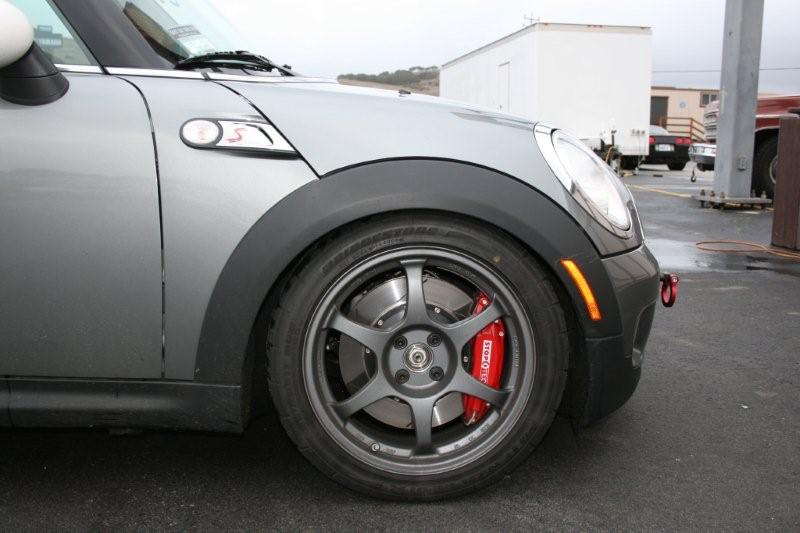

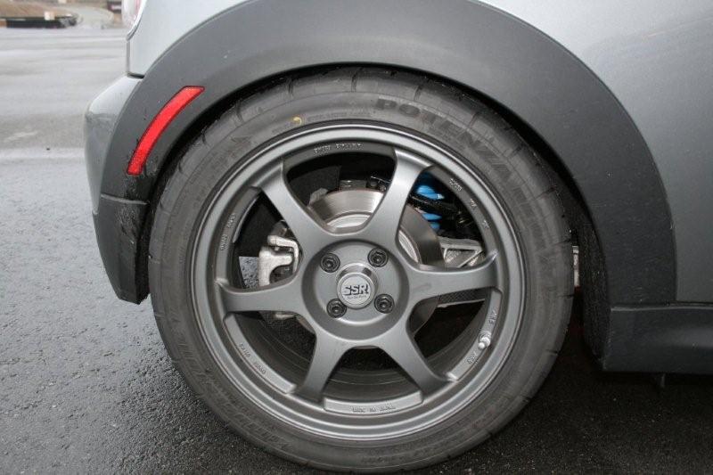

Old Jan 31, 2008 | 10:01 PM
enmejia's Avatar
enmejia
Joined: Oct 2007
Bridgestone 235/40/17
Bridgestone 235/40 with 17x7.5" SSR wheels
Attached Thumbnails 235s on a R56!-img_6230-copy.jpg   235s on a R56!-img_6234-copy.jpg
