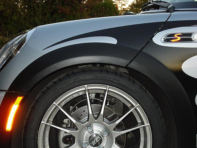

Here mine with the JCW, I had the JCW put on before I bought the car so I have nothing to compare it to, but I love it.
