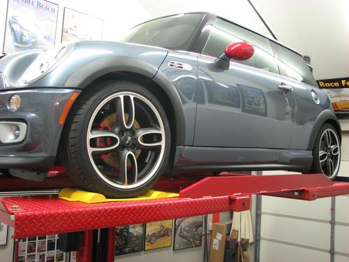

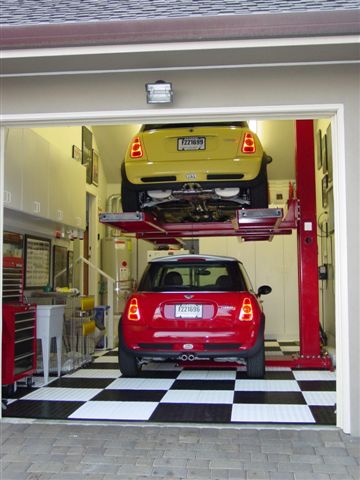

Why not a single post lift?
I had a 4 post lift for several years in a single car garage (with a 17 ft peak at the center) but I was always hitting my head, and the posts made it difficult to get around, so I was lucky enough to find a single-post unit from American Custom Lifts www.aclifts.com . It's called the Maximum One. See
http://aclifts.com/parking/m1-65.asp
Here's a couple of photos:
Attached Thumbnails Any Lift Recommendations?-0032-in-pg.jpg   Any Lift Recommendations?-minis-in-pg-2.jpg

Chief Charlie -- That lift looks great. I assume that the post is anchored into the floor. What does that entail? And if you don't mind me asking, what did it all cost (lift plus installation)?
I was leaning toward a four-post lift because they seem less expensive and I wanted to avoid the added expense and hassle of anchoring the lift to the floor, but the four posts will definitely make getting around the garage a bit of a hassle. My primary reason for wanting the lift is storage, but I'd also use it for doing some minor servicing of the cars.
Patagonian GT -- Thanks for the tip on the inclined floor. I wouldn't have thought of that. I'll definitely take precise measurements before moving ahead. Rough measurements show that it should work, but I'll have to remove the automatic garage door opener.

If I recall correctly, it was around $6,000 installed. I'd email brad@aclifts.com and get current pricing. The lifts were made in Texas and shipped to CA; and you need a forklift on site to get the column in place.
I can send you some other photos when I get to my PC at work. PM me with an email address and I'll send them along with an explanation of how it works.
In the meantime, email Brad. They're in So Cal.
I use it mainly for storage as well since the city wouldn't allow us a 2 car garage when we remodeled nearly 10 years ago. I told the contractor make the roof high and he did.

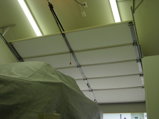

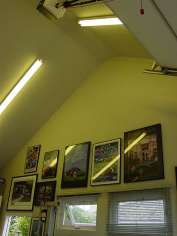

When you open the garage door, does it follow up the angle of the roof?

yes it does. Here are a couple of photos. The one of the opener is before the new rack was installed; and the one showing the door against the ceiling is pre- new lift as well. You get lots of room this way; and if the peak went in the opposite direction, you might be able to do the same thing (follow the wall over the door) before having to turn in towards the interior of the garage.
I had an 8 foot tall garage door opening created when the garage was built (normally they're just 7 ft tall) and it made it much easier rolling out the old lift intact, and getting the forklift inside the garage to set the new lift's column in place.

sweet.
