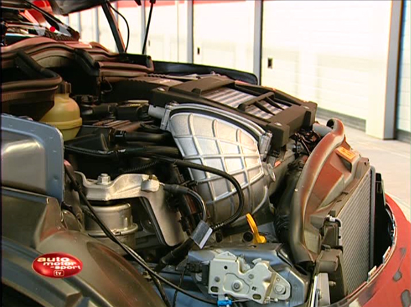

From: Flying My Roflcopter
hmmm... that pic of the gp makes it look like it doesn't have hte lower radiator that my 06 mcs has. I have the one that the new m7 air diverter goes on top of and this gp looks like it doesn't...
any ideas>?

Yes, that GP doesn't have the airconditioning radiator installed.
I saw 5 GPs at the Sandia Motor Speedway in Albuquerque on Thursday and they didn't *seem* to have 218HP...but then again, the owners weren't letting the locals who knew the track behind the wheel! Good thing too.
They look cool, that's for sure.
