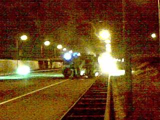

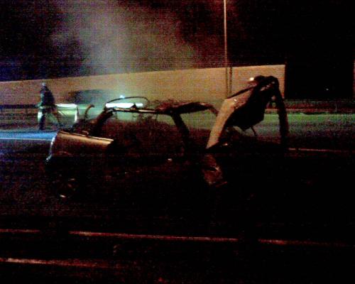

Last Monday, I lost my 06/2005 Mini Cooper S Convertible JCW. Driving in the middle lane doing 120 km/h (app 80 miles, max speed in the Netherlands) at 22.30h I suddenly heared a loud explosion sound on the front right side and I immediately lost all power. Steering to the shoulder, in the right lane I saw a flame coming out of the bonnet airintake hole. Oops. Drove immediately to the shoulder where I wanted to brake but the brakes totally failed.I stopped by using the handbrake and got out. Got back in twice to save some personal things (wasn't thinking by then...) while phoning the alarm nr. Fire dept was ther in 10 minutes but by then nothing was left of my 'pride-n-joy'.
My brother was driving behind me, heared the loud bang and immediately the underside of my engine was on fire. He saw the flames (that I could not see by then) and smelled the car burning.
Bye bye lease car, you brought me fun while it lasted.
Here are some pics of the moment and of the day after.

and the day after...
