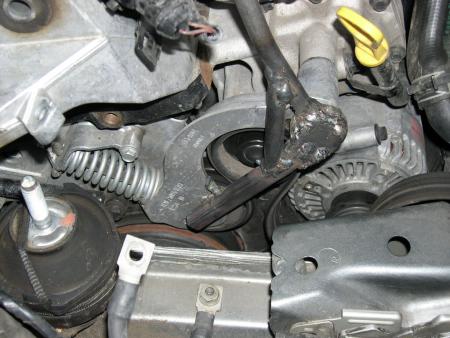

I watched and took notes last month as Randy Webb did S/C pulley installs.
http://store.webbmotorsports.com/for...topic.php?t=17
He uses a home-made tensioner tool to release tension on the belt,
and a standard pulley removal tool. He loans the tools for free if you buy the pulley from him.
His procedure looked quick and easy if you unbolt/bolt the tensioner's 4 bolts in a specific order (remove the 2 smallest/middle bolts last, and reinstall them 1st).
I plan on doing my own pulley with these steps, and I'm not convinced that the "deluxe supercharger pulley removal tool" has any significant advantage -- just more risk in damaging the shaft on which the pulley mounts.
Given the correct order, I disagree with the claim, "Leaving the tensioner on easily saves 15-30 minutes of hassle"
http://outmotoring.com/deluxe_superc...oval_tool.html
There were some clarifications to the instructions, mostly where to look when you're jacking up the engine to avoid damage. I can post those when I finish with them if there's interest.
