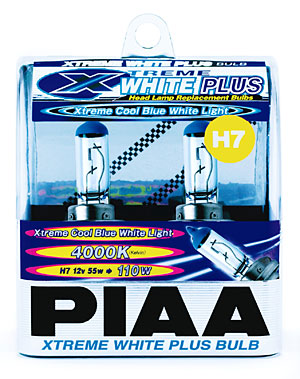

The Mini uses PIAA H7 for Low and High Beam
We have the Xtreme White Plus in stock
Price is $72.00 per pack(2)
Victor

Originally Posted by Mini Works
I disagree with some of you,
We know. Read http://danielsternlighting.com/tech/...uperwhite.html
He's right. You can't change the laws of physics via marketing.
The better H7s are the European Philips VisionPlus or Osram SilverStar (not the silverstars sold in US. The european versions). About $35 for a pair.
Or, as Greatbear mentions, get the 65w Osrams, for about $50/pair.
65w is ALWAYS better than 55w. .... More power, more light. Physics 101.
Sorry ... just trying to bring a full perspective rather than a pure marketing perspective into the discussion.
