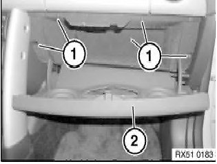

I'm not sure that the latch mechanism can be removed separately, but the entire glovebox is easy to remove if that will help. Pull off and disconnect the glovebox light, then remove the 5 screws indicated by (1). Disconnect the glovebox a/c hose while you're pulling it out.
Easy to take out, but harder to put it back in . The two side screws are awkward to get started. It helped me to tape the screw to my Torx driver so it wouldn't fall down while I was trying to get the screw in the hole.
