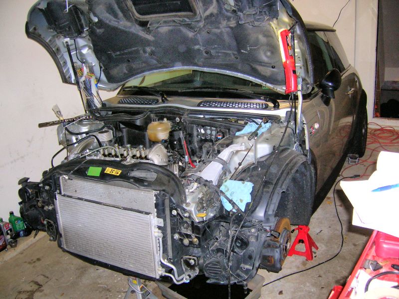

Well this weekend I've finally removed the head en route to a helicoil in cylinder #2. I've decided to go with the stock head gasket and some Bosch Platinum 4's instead of the Denso's. Hopefully this will help with the spark plug issue but I'm going to torque them down every month for sure. This was a pain...
I also need to remove my 15% pulley to qualify for STX...
So...as promised...here are some pictures. It's been over a month since I've driven the car and I can't wait to get it all back together. It's unbelievable how much crap I had to remove from the car just to get the head off. All this to avoid metal chips in the motor....a lot of work but now at least I know more about the car.
Other mods I'm doing before autox season include front camber plates, Schroth harnesses, and I'm going to look for some Koni's possibly.
Anyone got any advice for putting it all back together? Everything looks pretty standard so it should go well. I'll post some more when its back together...
