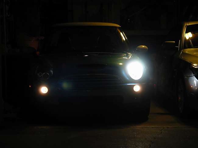

How many have had their Xenons go out on their MINI? I'm trying to see how often this occurs... I thought they were suppose to last like a lifetime...

You mean the daytime running lights? No I dont. and even if i did those are the high beams (halogen bulbs) ran at half power.

I dropped off the car this morning at 6:30 with the headlight out and now they call 2 hours later saying it works fine. I've been monitoring it for the past 2 days and its been out everytime. I even tried hitting it to see if its somthing loose.
