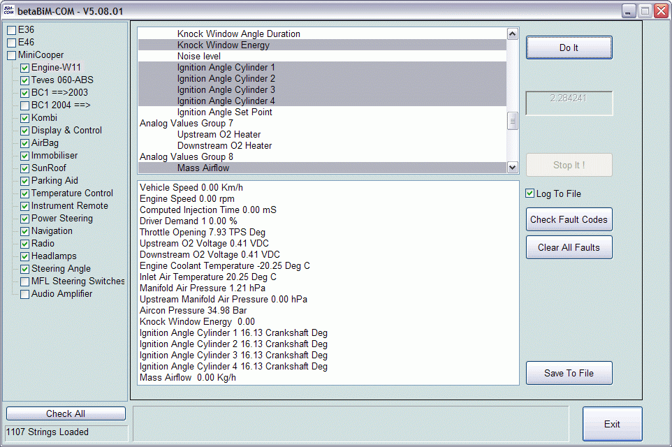

I hooked up our prototype BiM-COM logger this morning to try to document the event. I logged as many variables as possible, at the expense of sample rate, but what I found is that ignition timing is 27 degrees BTDC while cranking. That stayed the same for each cylinder, both in the NO-START and in the YES-START scenario. Tomorrow, I will try logging with fewer variables, specifically, throttle angle and injector pulse widths to see if I can catch variations between the two scenarios.

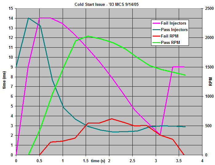

Okay, here are some preliminary findings. Thankfully, my engine didn't start on the first try this morning.
There is one notable difference in my logs between the Fail and Pass start attempts. There is a value called " Air Conditioning Compressor Relay Active". It can be either 0 (not active) or 1 (active). During the Fail start attempt, the value stayed at 1. During the Pass start attempt, the value was 0. It looks like it then went to 1 several seconds after the start. I'll have to do more testing to see if this is consistent. If the A/C compressor were engaging while the engine is trying to start, I could see that potentially creating problems. Now, why the value and behavior are different between the first and second starts of the day is unclear.
Here's a graph showing RPM and injector pulse widths for the Fail and Pass conditions:

Ah well, the "Air Conditioning Compressor Relay Active" was off during both the Fail and Pass starts this morning.
More research needed.
BTW, here's the stuff I logged (out of a possible 150+ variables):

This morning, I tried another test. Prior to starting the car, I checked and cleared fault codes (even though none were present). This should reset some adaptations (additive and multiplicative fuel trim, maybe others). It had no effect at all. I'll try clearing each of the specific adaptations:

Too bad this problem only manifests itself once a day with horrible regularity, so I can try clearing them one at a time (which will take up to 8 days) or just go hog wild and do all of them at once (which won't narrow down the problem if it proves to be a "cure").
EVOtech software hasn't cured the problem yet either as it's an underlying base software problem.
The dealership here in Portland is recommending that effected parties email them a really nasty letter so they can forward it on to BMWNA. (No, I am not kidding)
