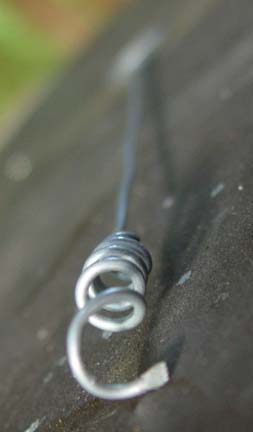

Make a cork screw. a few initial coils the size of whats left of the stink on up to the size of the tube. flatten the end with a hammer. Screw it on. Say the mandatory cursive phrase & remove it. Now use another cursive phrase & try again Thinner wire will act as chinese finger cuffs. Hold on I'll go break mine off & let you know.....
And I think you can get something like some music wire from your local hobby shop (I build r/c planes so I'm alway tinkering, repairing) Ask someone there were there metal tubing/music wire is and they can help you.
Make a "dipstick" or in this case a "dip-trick"
Take your music wire and cut it to length for your dipstick. Wrap one end around the shaft of something small like a screwdriver, then clamp down on it with some vice grips and wrap around about 5 or so turns to form your corksrew. But remember if you screw up, don't go trying to redo the wire. Music wire is very forgiving, but it's not that maleable. It could break off if you try to mess with it too much before you insert it in your engine.
I would get several wires, so you can get it right and have room for mistakes. (The corkscrew will have to be very small in diameter to get down that curvy plumbing so I would experement and take your time here so it will still fit down the tubing. Give it a twist as you insert (as the owner of an S, I empathize–I usually turn the dipstick as I reinsert it. Keep on twisting–just make sure you turn in the direction of the open end of the screw so you can wrap your cork screw end around the end of the broken off dips stick.
NOTE: I have not tried this–I am just offering this as a suggestion following the brilliant post above. I did put on my own pulley myself–took 12 hours with a jury-rigged belt tensioner tool and I managed to break my neighbor's crow's foot in the process! But I did get it right. So take this post with a grain of salt. Good luck and I feel your pain!
-Jake
