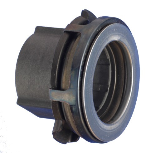

If you're asking me....my answer is no. The release bearing which looks like this
is not shown in this OEM diagram (below). The bearing slides along the sleeve shown as #1 in the diagram (your hotlink pic doesn't show up...I will hotlink from my post).

The release bearing is included in the oem clutch kit. ive had my clutched changed and the noise was still there.
